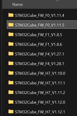

Hello... i recently downloaded STM32 example from ST website,  How can i load these example into CubeIDE ?

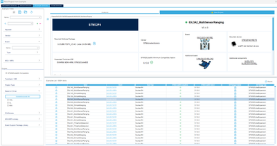

Easiest way is to just create a new Project, then select the example you want from the example selector:
Then the IDE will do it all for you ...
