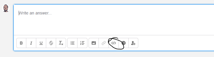

Use the code format in your text so we dont die trying to read you wall of text

Sorry :grinning_face_with_sweat:
