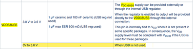

thanks @AScha.3 , I agree on this, I fact i suggested to keep zero ohm and tie it with VDD( 3.3V). but issue is we are in final stage of Gerber generation ( keept this pin NC) . Now need strong reason to modify it now.
also will you check on below snap?
if not used 0v to 3.6V. I not sure if 0V to 3.6V means not we can keep it NC.

From ds , 0...3v6 allowed, NC should be no problem for function of cpu.
But as always: a floating input (here power input) is not the "perfect" design idea.
