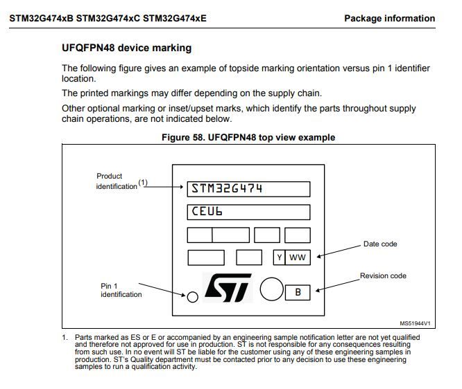

Sorry. I am using G431 and it just says "R" instead of Revision code in the datasheet. I have nucleo-G431, nucleo G474 and G431CBU. It writes on the codes I mentioned in my first article. Below is a photo for the Nucleo G431.
mckmk
Here, Rev code is written as "Z" next to the text ARM. Likewise, it says "Z" on the G474 chip. Rev code "Y" on G431CBU.
 I am having difficulty determining the Revision code because it says below in the datasheet.
If Rev X is coming out too far I'll have to go over the MCU options.
