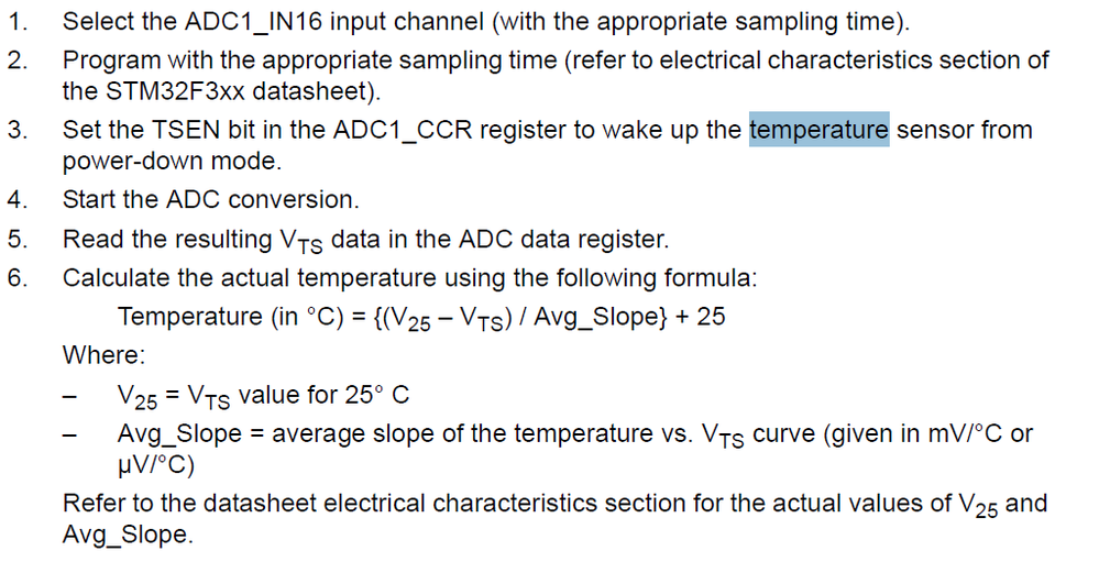

Hi, Everyone.
I'm tring to make adc sensor works, to find a temperature.
I found AVG_Slope and V_25 in the datasheet:
AVG_Slope = 0.0046
V_25 = 1.46
And I used V_Ref = 3.0f and N_Bit = 4096f
This is My code (Only for adc_complete conversion)
void HAL_ADC_ConvCpltCallback(ADC_HandleTypeDef* hadc)
   if (hadc->Instance == ADC1 ){
      float value;
      value = ((float)adc1_buff[3]/N_BIT)*V_REF;
      oil_temp = (float)(((V_25 - value)/Avg_Slope)+25);
      //oil_temp = value;
      //printf("Dato 1 %d, Dato 2 %d, Dato 3 %d, Dato 4 %d", adc1_buff[0], adc1_buff[1], adc1_buff[2], oil_temp);
   else if (hadc->Instance == ADC2 ){
      float val;
      float result;
      HAL_GPIO_TogglePin(GPIOB, LD3_Pin);
      result = HAL_ADC_GetValue(&hadc2);
      val = ((float)result/N_BIT)*V_REF;
      ntc = (float)(((V_25-val)/Avg_Slope)+25);
The problem is that resoult is crazy!
I found about 300° for 3.3 V in, so, surely, I'm doing some mistakes, but I can't find it.
Someone could me help to find them?
Many thanks!

I've seen this formula on the user manual:
And I tried it (first post), but temperature out is very strange, so, I need only this formula works.
I will adapte the V_Ref in function the sensor that I will connected, without changing the code, o, at least, that's what I'd like to do.

If you use an NTC temp sensor then the formula I gave you for processor temp is incorrect.
you will have to calculate your NTC ADC to Temperature Algorithm
