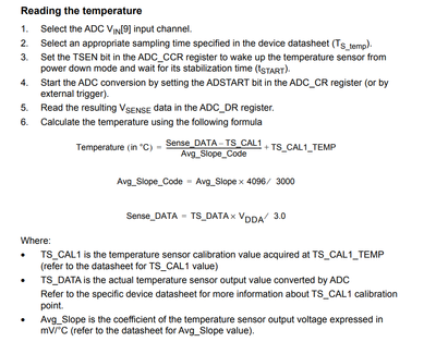

how do I read the temperature value of a STM32C071 ADC and convert it into °C using DMA? I cant find any formula in the datasheet.

The temperature sensor formula reading is provided in the reference manual RM0490 (page 321) of the product not in the datasheet:
