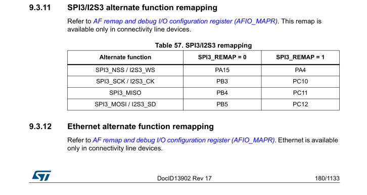

I want use M95512 (EEPROM) with STM32F103RCT6 SPI3
but now I check Oscilloscope SCK, MOSI, MISO. Only work MOSI have signal
now no work SCK.... How to Init. SPI3
Please check my code.
Thank you ^.^

waclawek.jan
GPIO_PinRemapConfig(GPIO_Remap_SPI3, ENABLE);
I don't use 'F1, but looking into RM0008 it appears that SPI3_SCK is at PB3 when SPI3 is *not* remapped.
Kim Sang Hyouk
Thank you ~ ^.^  waclawek.jan
I was  use like this. but work same (no SCK)
  GPIO_PinRemapConfig(GPIO_Remap_SWJ_JTAGDisable, ENABLE);
//  GPIO_PinRemapConfig(GPIO_Remap_SPI3, ENABLE);
I was use like this. but also  work same (no SCK)
//  GPIO_PinRemapConfig(GPIO_Remap_SWJ_JTAGDisable, ENABLE);
When I use SPI1 with M95512(EEPROM) than ... It's work...
But..... change SPI3..... no work...
Please check it.
Kim Sang Hyouk
​Now Can Work~....
I change position. end of GPIO Init
