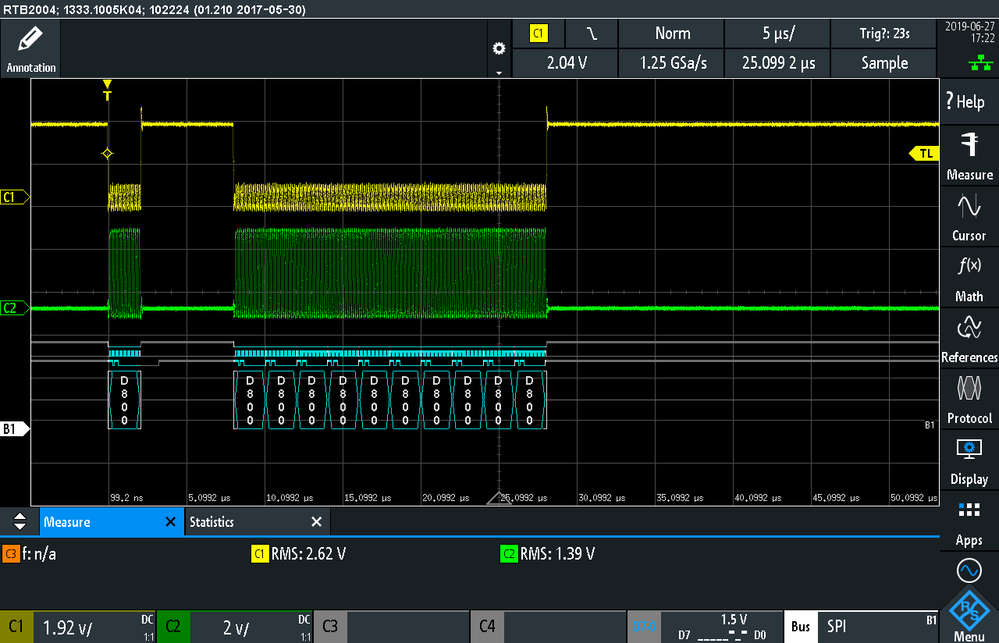

I am reading a burst of data 3072 half words from slave SPI device.
The Slave device requires NSS to be released after each half word transmission.
When I loop on HAL_SPI_TransmitReceive() function with size =1 for 3072 times it's OK.
but when I try to do it in one shoot using Size() with size = 3072 , the NSS is set low for the whole 3072.
the same happens when I try to use DMA "SPI NSS is low during the whole time of the 3072 half words".
I set NSSPMode = SPI_NSS_PULSE_ENABLE;

How can I generate pulse on NSS after each half word if I am reading the whole data in one shot or using DMA?

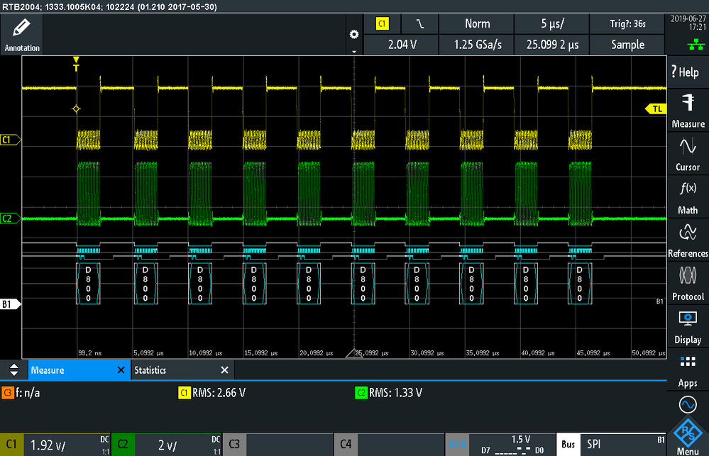

In the next picture NSS in Yellow and SCK in green, this is the required pattern, I get it when sending data one by one

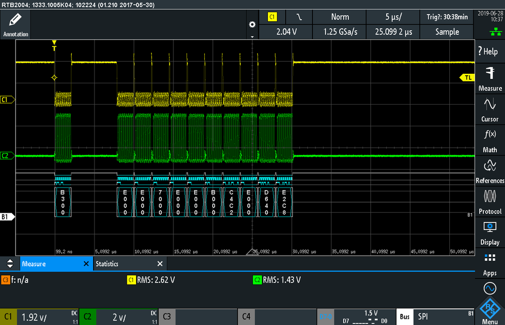

and in the next picture 1st half word is sent in one command and after that I start DMA,
you can see that NSS is kept low during the whole data transmission

thanks @Community member​
it was the MIDI, I should use a value greater than 1
Here's the working configurations

waclawek.jan
Set nonzero SPI_CFG2.MIDI, read Slave select (SS) pin management subchapter of the SPI chapter in RM.
