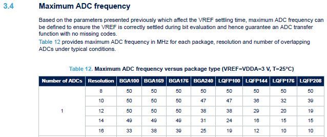

Have you found the answer yet? I also experiences same thing.
I tested both synchronous and asynchronous clock on my custom STM32H750VB.
All produce same result which is half of calculated value.
I even lower the ADC Clock to match what stated in datasheet(Max 19Mhz).

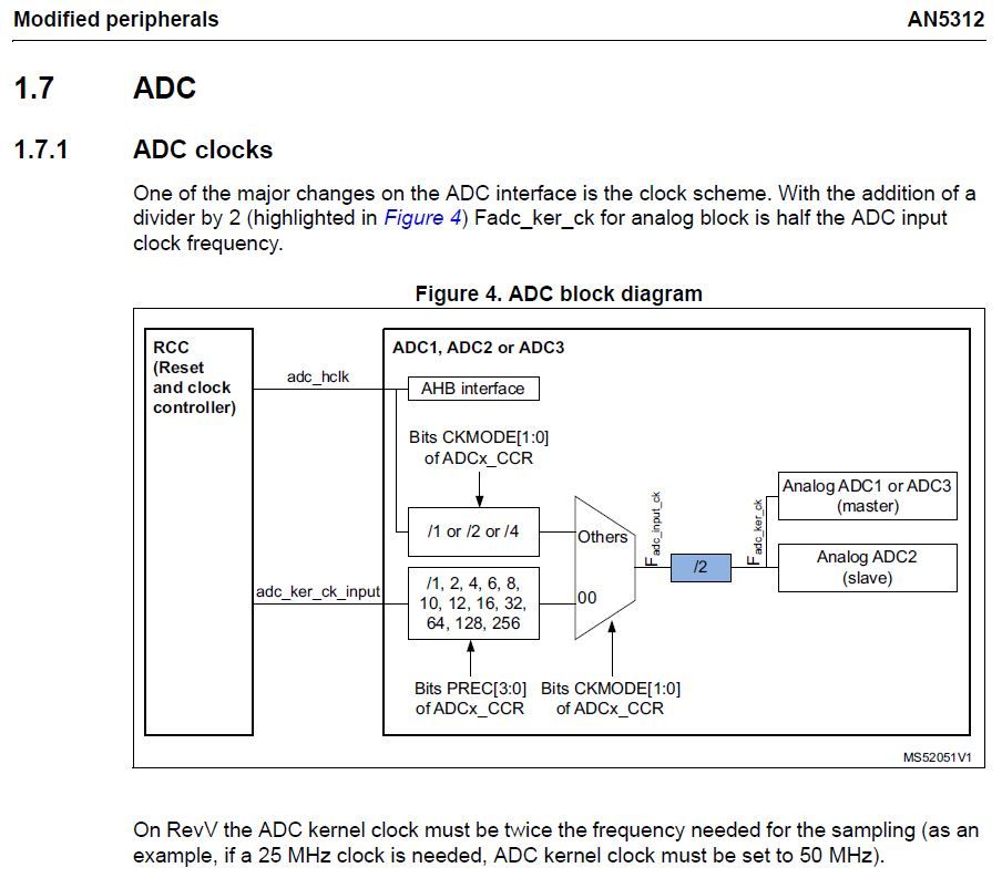

I found the answer, the STM32 Rev V had additional divider by 2,
Hence in order to get 19Mhz, the ADCCLK need to be 38Mhz.
Hope this help for other.
