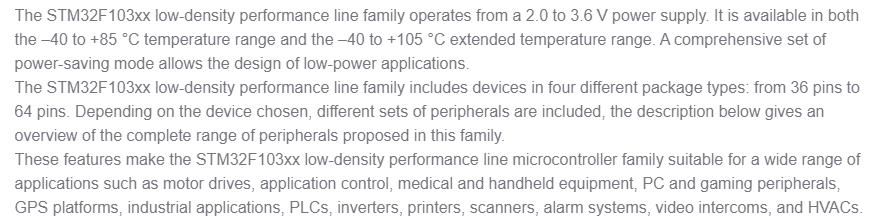

@Ozone​  before posting the question I read the description of STM32F103 in their portfolio and datasheet as well, which states that these microcontrollers can be used in medical devices but I could not find any supporting documents.
