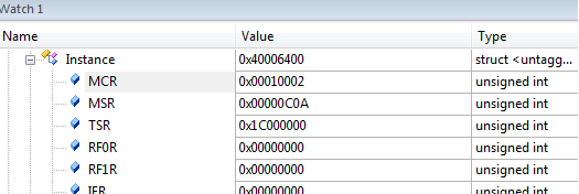

I'm trying to work via CAN bus and checking a simple  data transmision without using interruptions. I'm using stm32L476 mcu and HAL level drivers for discovery kit. I think all can configuration operations has correctly done looking to my var values during debug mode. But now I would like to unfreeze TX/RX CAN module for debugging.
The case is that I'm not able to clear the 16th bit (DBF) of MCR register. Actually I can't access any of the bits of this register since I'm watching this register but my instances does not have effect over it.

I'm debugging with keil ide, but when debugger pass through MCR instance field (instance is the declared HAL structure for init function) no bit has changed. You can seee how there is the reset value. I put breakpoint at the assignation statement and two steps after stop there, this is the image:
How would you do in order to access and write some bit of MCR in this case?

I have found the problem, I will share the solution with you in case of someone else is having the same situation.
I was trying to access this register before hal_init function call, hence, it turns on the cleared bit once again.
The solution was to move HCAN_Struct.Instance->MCR &=(uint32_t)CAN_MCR_DBF;
//unfreeze can - debug bit --> dbf=0 after
HAL_init()
sentence (out of if statement) inside init function void App_Task_CAN_init(void) {}.
