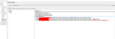

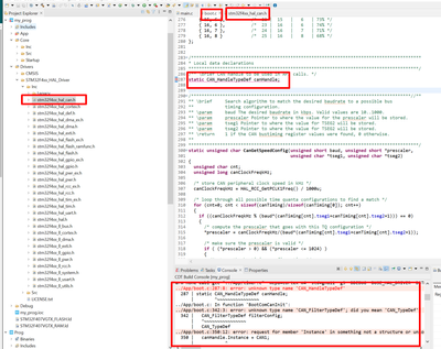

Hi All,
I am compiling my code, then I get the error below. As you can see, stm32f4xx.hal_can.h is included under project. But, when I click on open declaration for CAN_HandleTypeDef, it does not take me to the stm32f4xx.hal_can.h file. It is like the .h file is not included in the build.
I have confirmed project properties includes stm32f4xx.hal_can.h is under included directories (please see the last snapshot).
Could anyone please guide me with this ?
Thanks.

../App/boot.c:287:8: error: unknown type name 'CAN_HandleTypeDef'
287 | static CAN_HandleTypeDef canHandle;

‎2024-01-28 1:44 AM
Check which subcomponents are enabled in stm32f4xx_hal_conf.h
