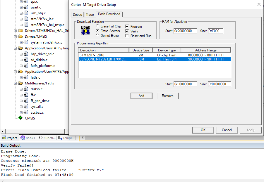

everything is working, downloads and runs, I am still not sure it the external QSPI works.
I can write and read from QSPI, checked but I am not sure if it works as external flash to load the code and run from it.
I chose to put main.c in external flash (is this the way you do ?)
but the bar in Keil only and always shows that it is loading to internal flash

I do not think that it is the loader, I tried the one you did, then I tried to make my own following AN333 from ARM/Keil , each time I hit the same error. I see that other people were asking about the same error before with no solution.
I checked the QSPI I can write and read from it error free using the standard library. It communicates fine. I used the same clock settings (and lower) when writing the loader. Maybe different board will work.I tried STM32F469I-DISCO it is loading into external QSPI using the predefined loader in Keil, no errors but sits frozen.
I wonder if there anybody who actually has working project in Keil.
