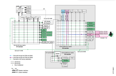

Hello @dorawa ,
The DCMI is a slave AHB2 peripheral. The DMA1 and DMA2 perform the data transfer from the DCMI to internal
SRAMs or external memories through the FMC as shown in the below figure.
Note that, if you want to display images correctly, YCbCr data must be converted into RGB565 data (or RGB888 or ARGB8888, depending on the application needs). So, on each DCMI frame event callback, the DMA2D is used to copy and convert the frame.
The HAL_DCMI_Start_DMA function checks the resolution, if the resolution higher than 65535 the DCMI double buffer mode is called and start DMA multi buffer transfer HAL_DMAEx_MultiBufferStart_IT function.
