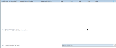

Some interesting findings:
Here is DEBUG setup from STM32CubeMX(version 6.9.2). Seems the TRACESWO could only be connected to ARM Cortex-M7(There is no Cortex-M4 options. And DEBUG module has been enabled from both M7 and M4 core in CubeMX)...
Could be a bug in CubeMX?

Hello @Leon_MS ,
Thank you for your feedback.
An internal ticket 166529 has been reported about CubeMX.
Further explanation is detailed in your thread Solved: Best practices for instrumentation logging with du... - STMicroelectronics Community
