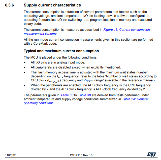

How to calculate the power consumption of STM32H743 from datasheet, theoretically as close as possible to the actual value? What parameters should be considered?
Also, I want to calculate the heat generated from MCU -- dissipated power (in W). How to calculate that?
2 REPLIES 2
Andrew Neil
You can never do an exact calculation - it will always be an estimate
The datasheet gives you power consumption figures - use them.
There is also a power estimator in CubeMX (standalone, or within CubeIDE).
Or use a dev board, and measure it.
PS:
https://www.st.com/resource/en/datasheet/stm32h743vi.pdf#page=110
