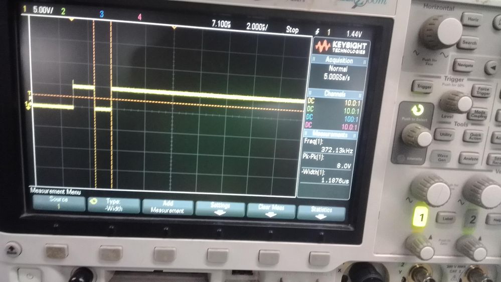

in our project 16MHz is system clock so if 1 instruction per clock cycle then 1/16MHz = 0.000000625 i.e 625ns. we are calculating time duration by using following code. as per above calculation 0.000000625 * 240 = 150us but we are getting 74us on scope. please help me on this
		HAL_GPIO_WritePin(BRE_EN_GPIO_Port, BRE_EN_Pin, GPIO_PIN_SET);
		for (i =0; i < 240; i++);
		HAL_GPIO_WritePin(BRE_EN_GPIO_Port, BRE_EN_Pin, GPIO_PIN_RESET);
2 points:
  • check the assembly code. The compiler might optimize "useless" code
  • GPIO access take >1 cycles.
What you can do is putting a bunch of
asm volatile("nop;");
instructions between set/reset. For example, use a macro to group 10 nops and another macro to group 10 groups of 10.
Measure several points and draw an xy-diagram to get an idea about the delay caused by HAL_GPIO_WritePin.

0693W00000HoyhXQAR.jpgwe tried method you have suggested but getting 1.1876 us time with nop operation. without nop operations it was 560ns
The F1 flash is VERY slow
Zero wait state testing would have been done running code from RAM
One should avoid RWM on GPIO->ODR, but rather use GPIO->BSRR

Do the math once more... ;) The period of 16 MHz clock is 62,5 ns and 240 cycles will take 15 us. On ARM the fastest possible loop consists of SUB and BNE instructions and will take at least 2 cycles. Therefore your loop will take at least 30 us.
You don't need NOPs there, just define the variable i with a volatile type qualifier.
