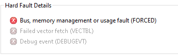

I have a board with a STM32H730 chip, my RAM is configured as not cacheable and instruction access disabled,as performance decreases a lot otherwise, but now i'm getting a hardfault after drawCachedAreas(); is executed,
As i can't see what that function is doing, i thought that mayb someone could help me.
If someone is invested enough here is my MPU config

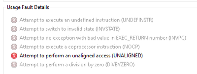

Hello @I_ve_got_a_problem ,
I am no expert on cache but it says it is not aligned.

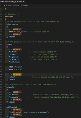

In the linker script, do you align your sections like we do :

I also suspected it was an alignment problem, but I have tried different alignments and none have worked, so I came back to the one the .ioc generates for touchgfx,
What makes it hard to debug, is the fact that I have no clue of what Application::drawCachedAreas() does, since it is already compiled in the touchgfx library.
I know the problem isn't the function itself, but rather my MPU_Configuration, but i can't know where is faulting, so I lack a starting point.
