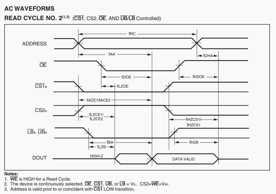

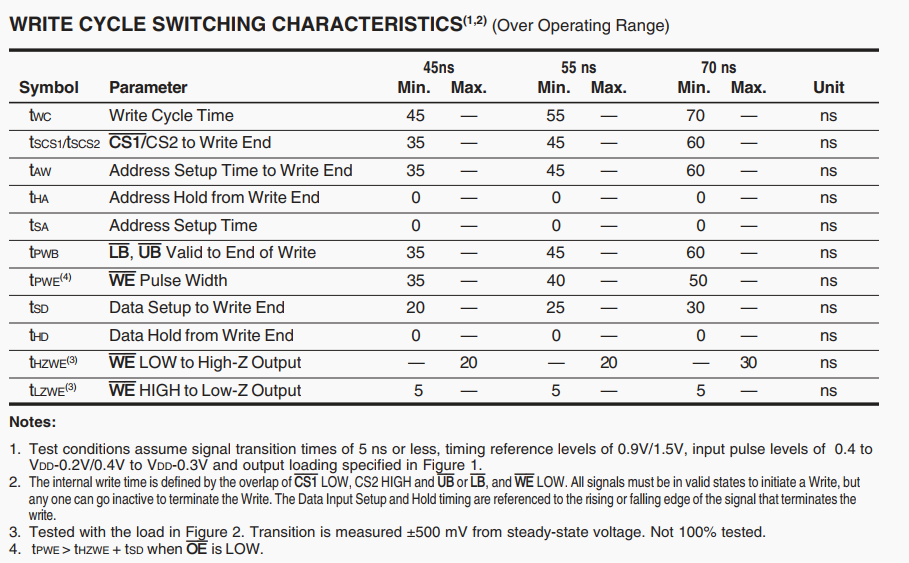

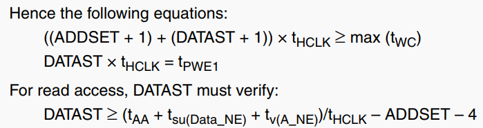

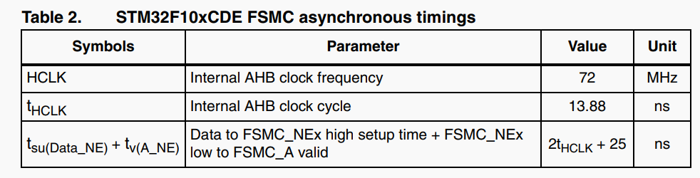

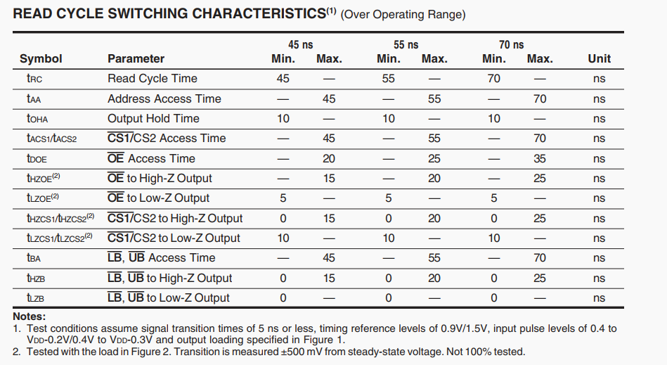

I use FSMC in STM32F407 to access external SRAM IS62WV51216. I read RM0090 and AN2784, gives me two fomula
tSU means
here is the timing graph

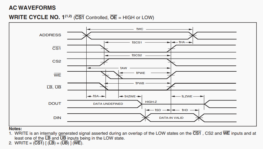

here is write timing graph
- why WE have two falling edges on the left
- what dose tSU tV mean,where is it in the timing graph please draw it. My ENglish is not good and I have some issues on reading, don`t understand "Data to FSMC_NEx high low to FSMC_A valid setup time + FSMC_NEx".It is conflict.
- Where is ADDSET and DATAST in STM32 parallal in SRAM timing graph, how to calculate ADDSET and DATAST, I really nead your help.
