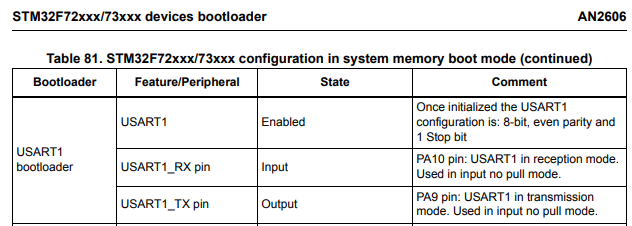

I was checking the APP Note AN2606, so using USART1 (for example) we can flash/debug the MCU, boot0 (PIN 138) must be connected to GND, so, Main Flash memory is selected as boot space.
So, the ST-LINK V2 (wired as TX-RX(MCU), RX-TX(MCU), GND-GND(MCU) and VDD-VDD(MCU)) using pins: PA10 and PA9, it should work

"....boot0 (PIN 138) must be connected to GND..." ? I may not be understanding what you are trying to do, but if you connect BOOT0 pin directly to ground you will be limiting your programming options. I connect the Boot0 pin to a pull-down resistor (10k?) and a test pad/hole. That way I can pull the pin high using a spring loaded probe in a programming/test jig when I need to re-program/test. My jig connects to GND, VCC, TX, RX, BOOT0 via spring loaded test probes (my boards tend to be smallish, so I don't have much room for connectors)
Hi gregstm.
When I said PIN 138 connected to GND, I was thinking in a final project board, no in an experimental board, but I was thinking to use a header to be used when I needed to burn the program or change it any time I need if it necessary..... but always thinking to use Flash area..... is it wrong? Maybe I am trying to do something that is not correct.....
As I told you, my idea is to make a final board...but having the option to burn/replace the MCU program.....
any comment/advice is wellcome...
