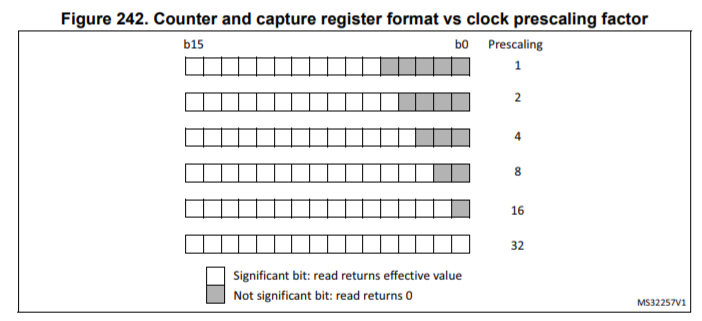

The reason why I'm asking is "Figure 242. Counter and capture register format vs clock prescaling factor" from the manual of STM32F334xx.
It essentially states, that when I multiply clock f_HRCK by factor 2, I lose one bit of precision. So the actual PWM time precision stays the same regardless of the f_HRCK.

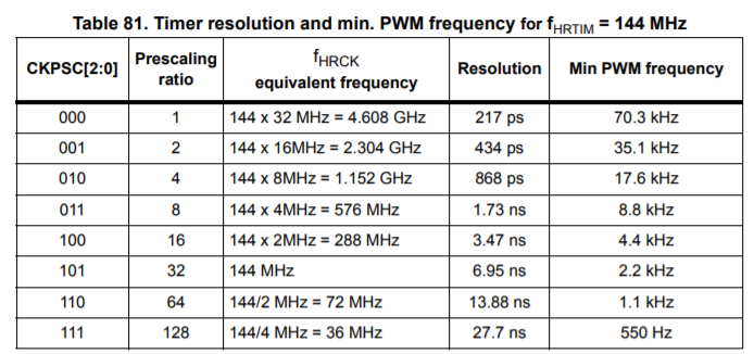

Or following this table:
If I have configured HRTIM with maximum equivalent frequency of 4.608 GHz (CKPSC = 000), then I can specify period and compare register only in values multiple by 32, since all 5 LSB bits became disabled/not significant (according to Figure 242). As a result I still have 217ps * 32 = 6.95ns effective time resolution, as it is without frequency multiplication of the clock (when CKPSC = 101). So I cant use the advantages of this high frequency clock and claimed 217ps resolution.

Of course the timer does not run at 4.6GHz, so you can't expect the synchronous stuff (counters, captures) to run at 217ps resolution.
All the magic is in delay lines with selectable taps at the outputs. The HRTIM is very complex, as it wants to cater for various options, and that ST did not want to tell out aloud the "delay line" word for marketing reasons, and tries to mimic a timer running at much higher speed, significantly hurts the legibility of the documentation.

I suggest to start with the demo code included in the STM32Cube_FW_F3 library. There are some simple demos in the STM32F3348-Discovery Examples (eg HRTIM_BasicPWM). There is also a HRTIM_Snippets version if you prefer directly with registers (you'll see you don't need to write many registers to get a basic PWM with 217ps resolution). This is documented in the HRTIMER cookbook (AN4539).
Two ways to clearly see the high-resolution:
  • using two PWM outputs, one with constant duty cycle and the other continuously adjusting the duty cycle with 217ps steps (let's say from 1 to 32, in a loop). Using infinite persistence, you'll see the high-resolution steps.
  • With a similar principle, using a low-pass filter. This is done in the STM32Cube_FW_F3_V1.10.0\Projects\STM32F3348-Discovery\Demonstrations software, and described in the AN4885 (section 1.4.7 Triangle waveform generation).
