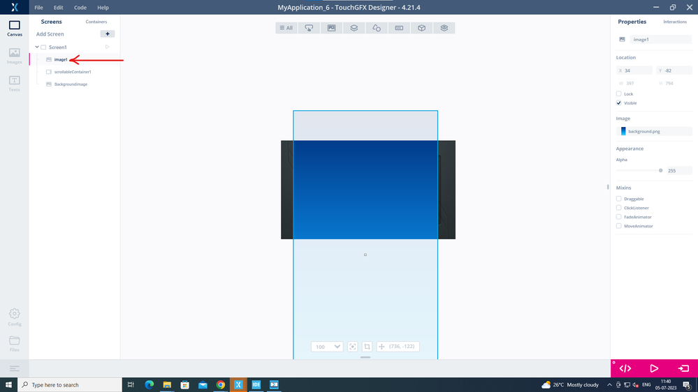

Hello all,
I am trying to scroll an image in the STM32F746G Discovery Board, using the Scrollable Container widget that is available in the Examples of Touch GFX Designer through STM32CubeIDE. But unfortunately the image is not scrolling and displaying a static image. I've referred to the documentation for the Scrollable Container in the Touch GFX Designer but the information given, is not enough for displaying the dynamic image(scrolling of an image) on the Board.
Are there any external peripherals to be configured for scrolling the image and how to configure the peripherals in STM32CubeIDE?
@https://support.touchgfx.com/docs/development/ui-development/ui-components/containers/scrollable-container
Thanks.

And your ticket ask image scroll, but backgroundimage isnt part of container here
Thank you for your response..Now I got an idea and I have implemented it successfully on simulator..
And now my doubt is how the scrolling is initiated by touch?
After seeing the file you have attached, I have tried and now my simulator works fine..
But how we can initiate the scrolling with Touch rather than the simulator?

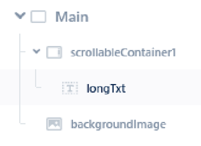

Hello @MM..1
Yes, I need an Image to be scrollable, but how the image is added in the Scrollable container, like in the example longTxt is in the part of scrollableContainer1.Scrollable_Container.png
MM..1
Chief III
Simply when you place red arrow click mouse and hold ... drag to any other level in tree
