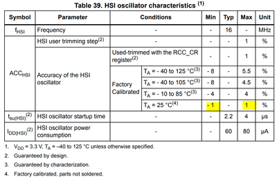

I tried using CubeMx, but only for PLL config. In my code that is fine, but when i try to generate a delay of lets say for eg 1ms i get output of only 981 microseconds. Due to this mismatch i think entire delay is changing. Can it be due to HSI.
Yes, absolutely. You're seeing an error of 1.9%. Let's check the datasheet for the HSI:
So it guarantees ±1% at ambient before part is soldered. Soldering will change that some. You can adjust the HSI using HSITRIM to get it more accurate.
If you need good accuracy, crystal+HSE is going to be much more accurate.
Also be aware ARR is preloaded and there's probably better ways to do delays, but that is a side issue.

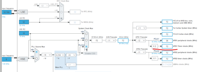

waclawek.jan
If you use APB prescaler other than 1, timer clock is 2x APB clock.
Exactly, but the thing is if i kept APB1 pre-scaler as /2 (72MHz / 2 = 36 MHz) then APB1 timer clock should be 2*APB clock (still 72MHz), now if i want to generate a precise blocking delay of 1 ms than what shall be my Timer pre-scaler settings.

DJ1
I understand the clock issue with HSI but as of now i am trying to test my system later we can switch the PLL input clock. As described, the issue lies when i try to test a blocking delay function, whose settings are
Pre-scaler  : 36000 and ARR is based on the user passes a value to a function. The thing is the timer is generating exactly half the time delay than expected. For eg: if i set 5 secs i get delay of 2.5sec. I think issue lies with Pre-scaling only. For that reason i set the TIMPRE bit in RCC_DCKCFGR register but no effect.
What can be the solution for this, as if i am setting a timer interrupt for every 1ms and increment a variable uptill 5000 then everything is fine but i fell thats not the solution
As the TIM clock is 72MHz and you can't set PSC to 72000-1 (as it's only 16-bit), set it to 36000-1 and multiply value to be written to ARR by 2 (and don't forget to subtract 1).
waclawek.jan
If APB divider is 2, TIM clock is the same in either of RCC_DCKCFGR.TIMPRE setting. Read RCC_DCKCFGR.TIMPRE description in RM.
True, but in CubeMX settings i can see APB1 clock settings different as well as Timer clock settings on that bus different
Thanks, the solution worked for me, but can you explain what does APB1 Timer clocks and APB1 peripheral clocks mean, like how are they different.
