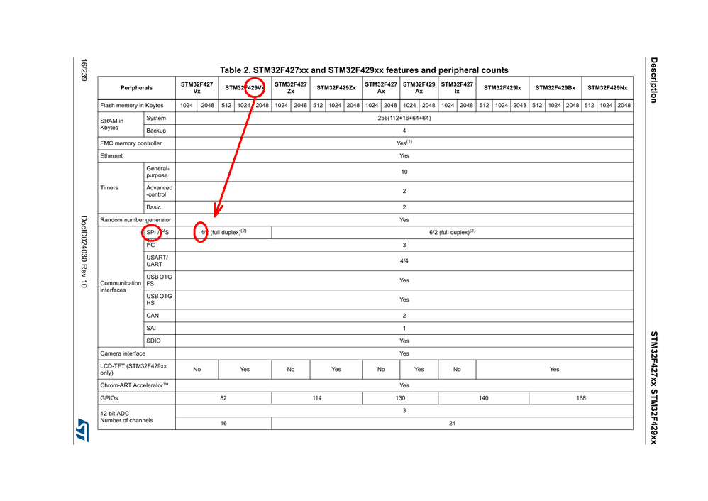

How many SPIs do STM32F429VIT6 have?
Bhuan.11
From the website, it shows there are 6 SPIs in STM32F429VIT6,
but from CubeMX Connectivity​ list, there are only 4 SPIs in STM32F429 series.
So which parameter is correct ?
B.R.
Billy
waclawek.jan
The SPIs are there on the silicon, but there are on pins which are not brought out in the 100-pin package.

I got it. Thank you for your reply.
