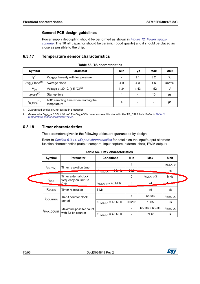

I am using STM32F030C8T6TR.
I have a process that needs to be counted precisely, so I'm connecting a timer oven oscillator with an extenal clock mod 2. How many MHz can I use( for maximum)? I'm using an internal clock for processor, it works at maximum 48 mhz.

waclawek.jan
> TIM1->SMCR |= (uint16_t)(TIM_TS_TI1FP1 | TIM_SMCR_SMS); // external mode 1
So, mode 1 or mode 2?
Although in both cases, the maximum input clock frequency is internal timer clock frequency / 2:

Why wouldn't you use the OCXO clock to run the MCU / PLL ? Should have fHSEext of 48 MHz
A slow MCU with 16-bit TIM, probably a poor choice for precision timing.
There should be an ETR connection allowing the TIM to reset against a 1PPS edge (or whatever), in HW with no SW or interrupt latency.
