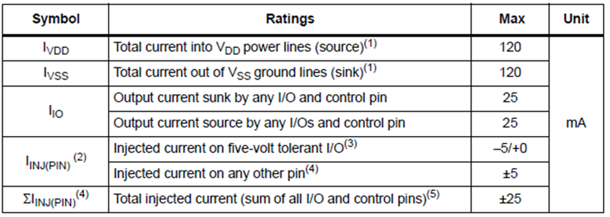

0693W00000QLcmoQAD.pngOutput current IIO is refered to the gpio configured as output pins?

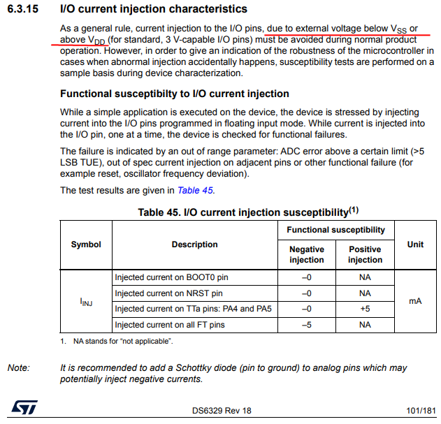

Injected current INJ is refered to the inputs? I think it is not, because injection could be possible in both cases, but.. I don't understand difference between injected current on pin and sunk current on pin. I'm asking only to be sure what this table mean.
Are those current values also applied to ADC inputs?
How can I find the real maximum number of pins at the same time? 25mA seems to be poor for 3 groups of pins. As design needs to keep a minimum number of 8 available ADC inputs. I think the card application could keep ADC group working not at the same time than the other ones. This will save total consumption.

Injected current is current which flows through protection structures ("diodes"), regardless of how the pin is set. You should avoid any current injection.

so which is the current value that mcu is able to tolerate before getting damaged when no injected current is present thanks to correct design? 25mA?

@genisuvi​ "Output current IIO is refered to the gpio configured as output pins?"
of course: as the table said, it is the current sunk/sourced by the pin - only an output pin is going to sink or source!
"How can I find the real maximum number of pins at the same time?"
In general, that isn't limited by current - it's just the number of available output pins.
If the outputs are only being used as logic control signals, there is no significant current involved.
EDIT
The current limits are only going to be a concern if you're working with (lots of) high-current loads; eg, (high-power) LEDs.

"I don't understand difference between injected current on pin and sunk current on pin"
See the definition in the datasheet:
