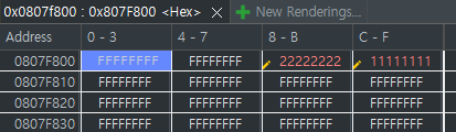

I have been working on the embedded flash memory of STM32G474RE and the whole programming process of the flash memory has been successful.

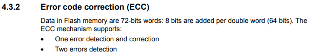

Referring to the reference manual,
8-bit ECC code is calculated and added per double word(64 bits).
If I interpreted correctly,
when 64-bit or 8 bytes data is programmed at some address, the 8-bit ECC code is calculated automatically and is stored in flash memory, following the data. Is it correct?
Here is the memory map of my test case:
0693W00000YAn2MQAT.pngData: 0x1111111122222222
Addr: 0x0807F808
As you can see, the data has been successfully stored in the designated address but I can't find where the ECC is.
It is quite confusing for me.

The ECC data is stored in bits which are not visible to you. You will only see the 64-bits of user data in the Flash line stored in the array. From a user perspective you'll see contiguous blocks of 8-bytes as you wrote them.​
