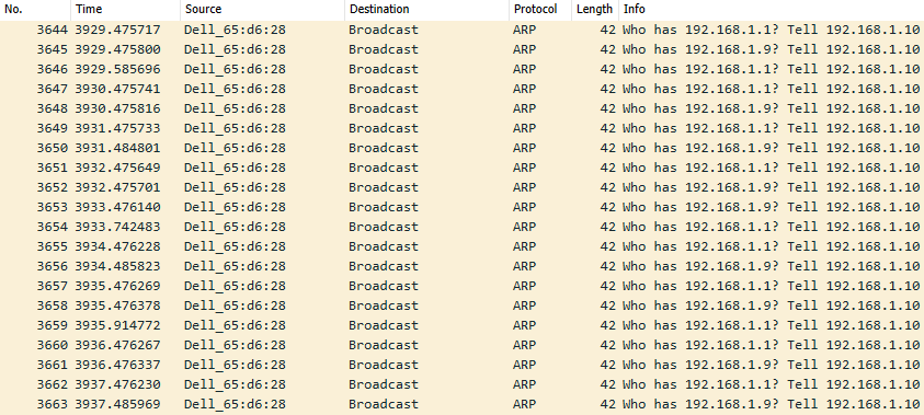

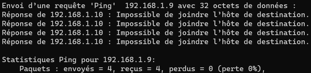

Here is the ethernet traffic between my computer and my dev board when I ping it :
0693W00000YAiLEQA1.pngand here the result of the ping command :
0693W00000YAiLiQAL.pngWe can see that the ping is in wireshark but I get any response from my dev board.
Where? All packets seen on your wireshark screenshot are ARPs from your computer. It does not get any response to these ARPs so it cannot even send ICMP packets (ping).

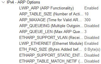

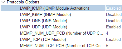

Yes I understand, so it's may be a configuration problem in CubeMX but I have tick some options in LWIP Configuration for icmp and arp like:
  • General settings :
  • Key Options (IPv4 - ARP Options)
  • Key Options (IPv4 - ICMP Options)
0693W00000YAlUJQA1.pngBut the computer need to get the IP and the MAC via ARP before to send a PING, is that right ?
If the ARP table of my computer doesn't have the IP and MAC address of my board I can't ping it. So I need to use etharp_request in my code ?
