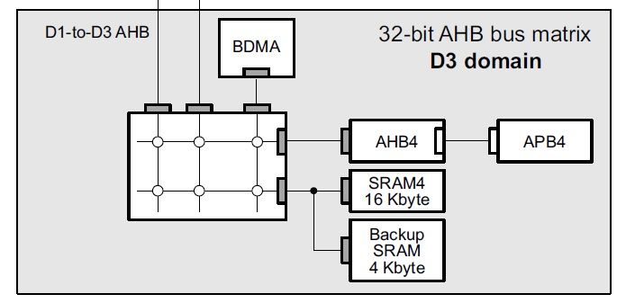

How do I move data continuously over DMA from an array in memory to a 8-bit set of GPIO pins/bus? I feel like this should be simple, but I am majorly stumped. I am using an STM32H7 Nucleo board.

Set up a timer to trigger a periodic DMA transfer. Set up that DMA stream to transfer between an array to GPIOx->BSRR. Only works if all pins are on the same port. Frequency will be limited so something on the order of 10 MHz.

0693W00000HnhZeQAJ.jpgWant a 16-bit write to ODR, or 32-bit to BSRR, would suggest the latter as you can pick the pins you want to leave an those you want to touch.
Seem to recall the GPIO is on AHB4, so perhaps SRAM4 via BDMA

After reading up on the H7 series, its looking like I have a few things I will need to do because of the problems with the M7's d-cache having issues with the DMA. I don't want to globally disable d-cache, as I will be doing more than just DMA transfers here, but yeah. The rabbit hole goes deeper on...

Simple way:
  1. Configure timer + circular mode + DMA
  2. Generate code
  3. Find HAL_TIM_Base_Start_DMA() function, copy-paste it to user code with a different name, for example MY_TIM_Base_Start_DMA().
  4. In renamed function find HAL_DMA_Start_IT() and replace TIMER register with GPIO register:
if (HAL_DMA_Start_IT(htim->hdma[TIM_DMA_ID_UPDATE],
     (uint32_t)pData,
     (uint32_t)&htim->Instance->ARR, // before
     Length) != HAL_OK)
     (uint32_t)pData,
     (uint32_t)&GPIOA->ODR, // after
     Length) != HAL_OK)
Use MY_TIM_Base_Start_DMA to start timer before main loop.
Also can be used with input capture + dma to provide external clock for data output, then you alter HAL_TIM_IC_Start_DMA(). Copy-paste it to user code, rename to MY_TIM_IC_Start_DMA and alter destination to GPIO register
