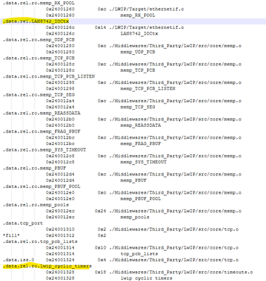

I could certainly continuously follow along the program fixing any hardfaults that occur but this seems very tedious and not very scalable. Is there a compiler flag that fixes this? Or someway of automatically, on startup, updating these function pointers? I could certainly just cycle through all of the .data region in RAM and add the offset to anything pointing towards the beginning of FLASH but that'll cause an issue for any data that isn't a function pointer but happens to lie within that region of values. I'm still new to linkers/map locations but by looking at where the function pointers are placed:
The top yellow highlight is the location of the first issue and the second was the second issue. They both seem to be stored in this ".data.rel" location within the map. I'm assuming this .rel has something to do with relocation but I don't have much experience with this and couldn't find much information on it online. Is there a way to dynamically reference this section of RAM so that on startup I can add the offset (to anything pointing to the wrong section of flash) within this subsection without potentially harming other data in memory. It does seem like this section isn't contiguous (.data.tcp_port is sandwiched in there) which has me concerned that this may not be possible.

Welcome to the club. Ideas of PIC code are attractive and have been discussed here. But IIRC no one succeeded - maybe besides happy owners of the IAR compiler.
So IMHO a better path would be relocatable image instead of PIC. The "loader" or update routine would patch the XIP code while writing it to flash, using list or table of relocations. The data in internal RAM and registers pointers remain absolute and won't need relocation. The final patched binary will be exactly same as the GCC produces now, without any overhead.
But I don't know if the GNU linker or binutils can do this. Since it is opensource, someone can try.
‎2024-10-30 11:24 AM
So then you'd advise leaving it as it is (fpic working for variables and most function calls) but then manually patching the bin files to update those specific .data.rel portions?
