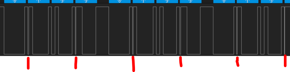

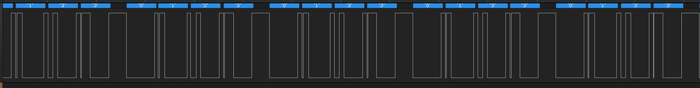

2021-12-15 2:05 AM
Hello STM32-Community,
I've changed my GPIO speed to "Very Fast", the highest speed available. 1 MBaud seemed to work fine, while everything beyond, e.g. 1.5MBaud did not work properly:
Any ideas how to resolve this?
Kind regards
2021-12-15 3:01 AM
Hi @crackl1ng ,
the GPIO speed setting sets the power of the GPIO driver. Basically the amount of energy necessary to make the transition from one level to the other level as fast and precise as possible. But the GPIO driver has it's limits. You need to check the electrical properties of the rest of the com line, capacity, inductance, resistance and make sure the load is al low as possible.
What's the distance from STM32 to the RS485 bus driver? Is the bus driver up to the task?
BR,
J.

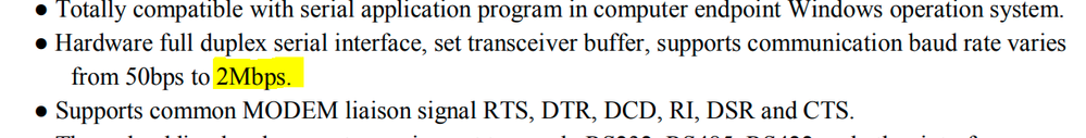

@TDK
I'm using an CH340 RS485 to USB converter to receive the data on the PC side. Its specifcation states it is capable of 6MBaud.
2021-12-15 2:50 PM
That signal plot is not okay. The start bit is much too short on most or all of the bytes. It's especially apparent when the LSB is 1. It would be nice to see the time scale for these. Is this from 1.5 MBaud or 1MBaud? What is the code that generates this signal?
A quick glance suggests the CH340 only works up to 2MBaud per the datasheet. Doesn't explain the issues at 1.5, of course.
https://cdn.sparkfun.com/datasheets/Dev/Arduino/Other/CH340DS1.PDF
2021-12-16 1:27 AM
I checked the specifications stated ont he website where I purchased them and it stated a 6 MBaud upper limit, though I suppose the data sheet is more correct.
The code I wrote for that is pretty simple. I do not send any data from a sensor yet, since I cannot approve the correctness of the signal therefore I have this simple loop:
for (int i = 0; i< 5; i++)
buf_send[i] = i;
while(1)
HAL_GPIO_WritePin(DE_485_GPIO_Port, DE_485_Pin, GPIO_PIN_SET);
HAL_UART_Transmit(&huart4, buf_send, 5, 0x1000);
HAL_GPIO_WritePin(DE_485_GPIO_Port, DE_485_Pin, GPIO_PIN_RESET);
//HAL_Delay(500);
The image is from the 1.5 MBaud analyzing.
