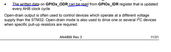

How do I check if an I/O pin is high or low (state of the pin)? When I toggle pins I want to know what variable to check.

have a look at this AN4899
Is your pin defined as gpio?

You can put a debug point after you toggle your pins, after it stops on debug point; you can see pin status from "Special Function Registers (SFRs)" screen. You can open that tab from Window-> Show View -> SFRs.
In SFRs screen you can check the Input Data Register (IDR) or Output Data Register (ORD) and verify that you're doing it right.
