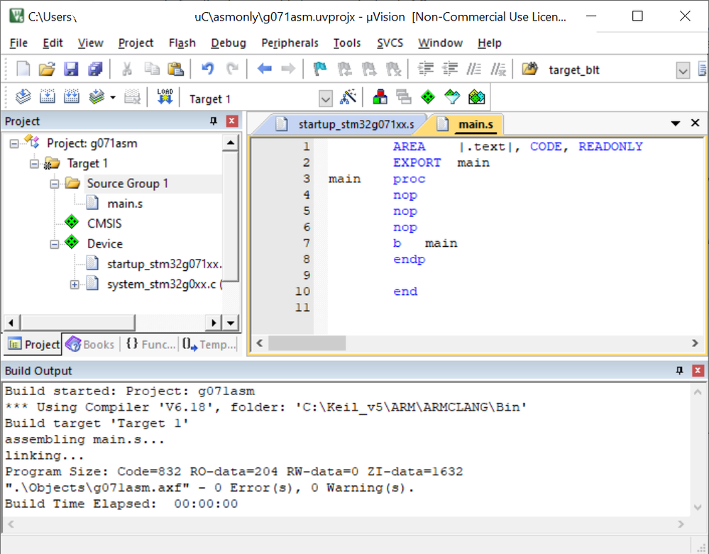

When you create a project with Keil, it does not even create a main function. You may simply write your main function in assembly language instead of C.

Perhaps take and example/template project, clone into another directory, and do you Assembler work directly into the startup.s file.

Let me, an old programmer with experience in about 20 assembly languages, disagree on this topic. Everything you want to see and understand, is in the assembly listing of your compiled code. Keil free version does not produce this output - another reason for switching to STM32CubeIDE to see the beautiful .list file. :)
ARM assembly is not for humans... ;) Ok, maybe reading is but writing - not.
ARMv6-M architecture was created to make it possible to avoid even a single line of assembly in the whole microcontroller firmware:
https://github.com/gbm-ii/Cortex-M_C_startup_gen
Proof of concept - as you can see, it's possible:

Hello @ihartavi​,
Welcome to ST community.
I think you can find a project that can help you here.
