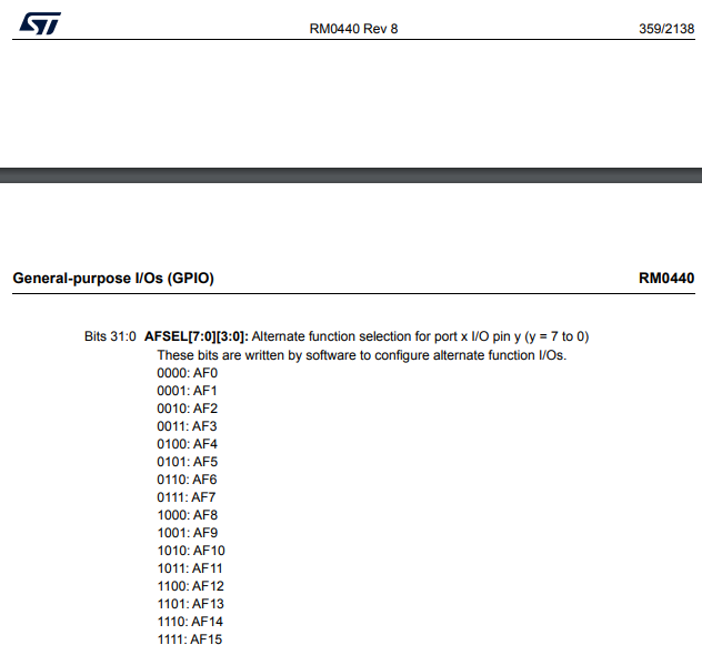

EDIT:
The AFSEL takes one value to select one AF - it's not a bitmap:
No

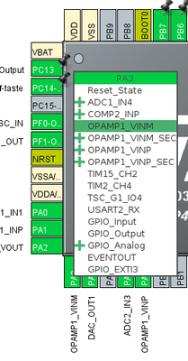

just try to enable both in CubeMx , if possible you can do it ( = if both on analog mux).
see on F303, the green "+" , can use comp, adc, opamp on same pin:
(Probably same on your G431 .)
And gen.code, just look, how Cube is doing/setting...then you know, how to do.
If need set AF , say TIMx , only one AF can be set in register for AF-function on a pin.
So impossible to set the AF mux to two different values same time. (need 2 pins then, as Tesla said.)

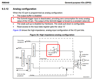

@MM..1 wrote:
say one AF plus some analogs.

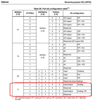

Doesn't selecting any analogue disable all AF ?
EDIT:
Yes, it does:
You see any more "+" here ? Then use it.
Otherwise you select other AF , maybe TIMx , then you have ONLY this AF.
I see , that MX dont do this. I ask is this possible by internal hw architecture ...

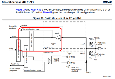

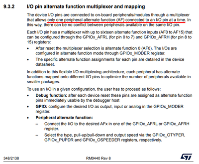

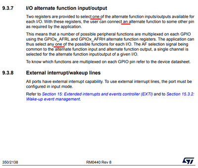

@Andrew Neil wrote:
you can only select one AF ?
Indeed - only one:
No: See RM screenshots.
tl;dr:
  • Only a maximum of one AF for each pin;
  • Selecting Analogue mode disables all AF.
