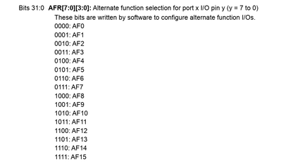

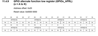

No. Cube is right. (here :) )
See rm : setting the AF ...ONE value per pin - so its ONE AF possible . dot .

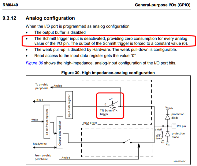

I agree one AF, but disagree many Analog. As is showed on your screens analog is always connected, next in MX you can see + GPIO_Analog not selected and this result i can set AF input capture TIM and manualy set ADC and COMP.
No.
see basic pin decision:
IF set to analog...you see yourself. :)

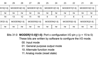

No i set primary AF 10 mode
I didn't say that.
I said that any analogue disables all AF.
But it says that activating Analogue disconnects the AF:
