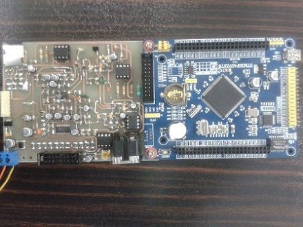

I use a simple evaluation STM32f407ez board with 25Mhz external crystal that give me 168Mhz CPU clock (I test it with TIM1). This board does not have SD card socket but I design a board that my external ADC and sd socket is on it (of course with some more circuit that is for driving my sensor). My pin out is as follow:
SD CARD: PC8 (SDIO_D0), PC9(SDIO_D1), PC10(SDIO_D2), PC11(SDIO_D3), PC12(SDIO_CK) and PD2(SDIO_CMD)
ADC: PF0, PF1, PF2, ?., PF11 (for 12 bit parallel ADC output)
PA8 (TIM1_CH1) for ADC Clock: ADC start conversation at rising edge of clock and I have to read out put (PF0-PF11) at falling edge and write on SD.
Cvile: have you tested the write bandwidth on that?
I don?t know how can I test the write bandwidth on board. I just test it on PC. In addition I think I can write it faster than PC because I don?t want use FAT format. I think if I write it without any special format it can help my writing speed.
Cvile: I'm not looking to code your project from scratch, so review the assorted examples posted already and mash together a starting point based on your hardware.
I found some code in forums that most of them are written by you Cvile and I try to use them. I have 2Mhz pulse on PA8 now, I connect it ADC clock pin. But I don?t know how I can configure DMA that read PF0-PF11 on falling edge of clock and write it on SD by SDIO. In addition do I have to
use two DMA(one for read from pin and other for SDIO)? Maybe if I buffer data and write a block on SD, was better, but how can I do it?!!
I attach my code and hardware photo to see them.

You'd want to time the writing of a large file, against an internal timer, like using a stopwatch. I'd recommend timing the write of 1000x 32KB blocks, and calculate the MBps from that operation. Smaller blocks sizes, and unaligned writes, will be slower.
Generating pulses and DMA actions against memory is a matter of picking timer(s) that use the pins you want, and the appropriate channels, and edge placement. The DMA table in the reference manual breaks down the available trigger sources, and I think I've also posted examples where an external edge can trigger the DMA. Yes you'll want to use DMA for the SDIO operations.
Not sure I'd skip the FatFs, it makes the card a lot easier to manage. Things need to use blocks which are aligned to the media in use, ie sectors, clusters, erase blocks, etc. Most problem occur when you make the system do a lot of unnecessary small/unaligned operations. I suggest you do the 1000x 32KB test at a file system, and block write level, and determine if FatFs really act as an impediment.
Depending on your buffer depth, you could perhaps look at using an STM32F4 with SDRAM support. Consider also the use of the DCMI for high speed parallel clocked data input.
