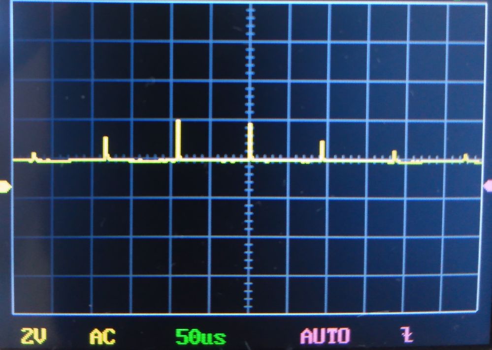

This is the signal from my GPIO pin C13 via a probe (see figure below, I had peaks around every 100us):
However, I see a constant flow of gibberish from my COM port, something like: “D@=EC>EE;@F=;HD9AG;<IB:DEGE99CEFNH9<A>�?
When I connect my ADC pin to ground, the flow of gibberish stops (meaning it is transmitting zeros?).
And when I connect my ADC pin to 3.3V, I get a constant flow of this symbol (denoting max voltage?): â–’â–’â–’â–’â–’â–’â–’â–’â–’â–’â–’â–’â–’â–’â–’â–’â–’â–’â–’â–’

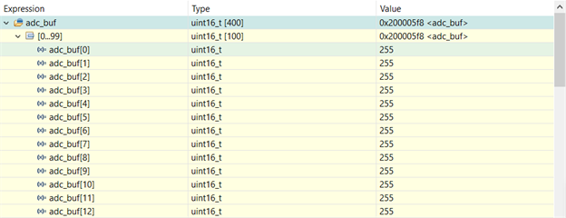

Nevertheless, when I pause my script in CubeIDE, I do see my buffer with ADC values:
Would you say that I’m getting closer to my objective? I’m not exactly sure what is wrong with my code.
Thank you so much!
