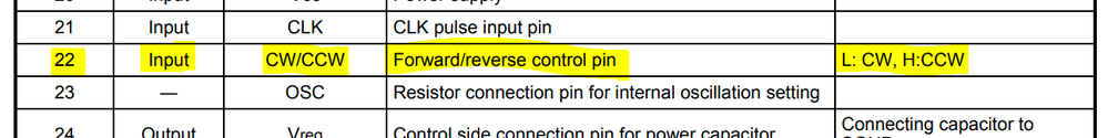

i am using stm32f103 controller with opto -circuit to rotate my motor . But my motor is rotating only in forward direction even if i make my direction pin SET or RESET . BUT i need to make my motor to rotate in both forward and reverse direction. Can anyone please help me how to do . Should i need to include any extra code in my program .

Stepper motors typically have a STEP and DIR signal. Toggle the DIR signal to change the direction of rotation.
Lchal.1
I have done the same thing in my code. But also the motor is not rotating anticlockwise.

The CW/CCW pin controls direction. Toggle it to change direction.
Configure it as a GPIO output pin, and toggle the output to change direction, as suggested in the first post.
