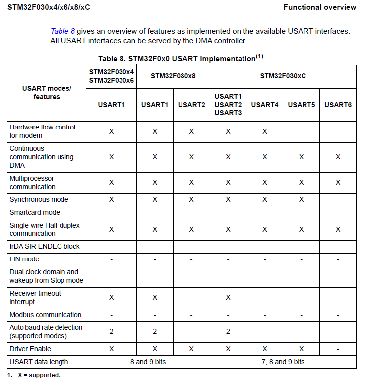

hi how to implement fifo with usart in stm32f0308
SSRIN.2
Iam new to stm32 microcontrollers, i have to read uart continuously and store to array. and size of the data received from uart is variable. if i use the fifo with uart i can solve problem.
so please help me how program to receive data from uart in fifo

@SSRIN.2 "iam using HAL_UART_Receive_DMA(&huart1, rxbuff,20)"
How, exactly, are you using it? Post your code.
Did you see the guide that @KnarfB​ linked? That covers DMA...
Fill the array in a byte-wise fashion, using ARR[6] byte, as it arrives, to determine the overall length of the packet, and how many bytes remain to complete the frame.

Or you use the fifo's in the UART or you use DMA, both together can create trouble.
Now problem with DMA can be that you do not know how many bytes you are about to receive. Therefore, for uart there is   HAL_UARTEx_ReceiveToIdle_DMA(m_pUart, m_dmaRxBuf, UART_RX_BUF_SIZE); receive to idle does what it says: receive until idle is detected on your UART. Using this will save you the trouble created by various lengths.
Best regards,
Johi.
can you please suggest me any example code
@Johi​  "use the fifo's in the UART"
Does an STM32F030R8T6 have any FIFOs in the UART?

for above uart problem solved, I used IDLE DMA UART RECEPTION, in this data reception with different sizes is resolved
i used HAL_UARTEx_ReceiveToIdle_DMA for data reception.
but in this, data reception UART stops suddenly. i didnt understand why this happening
please help me how to solve this "UART STOPS RECEIVE DATA". if we reset device it starts working
