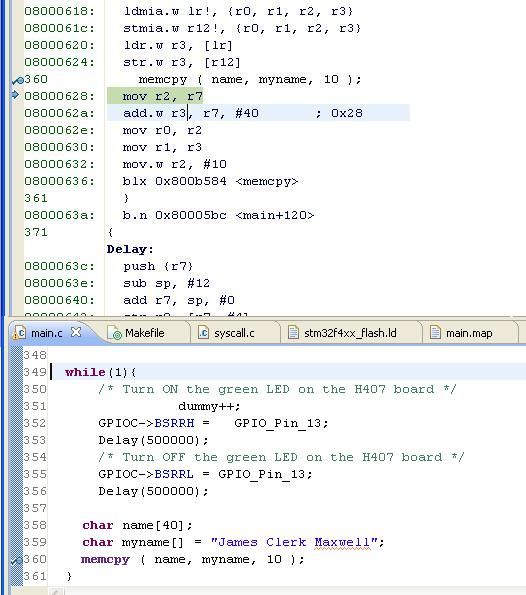

hello forum ,
I am trying to run a TCP/IP demo on a Olimex STM32F4 board
with eclipse + yagarto
however I cannot connect to the board with LAN
when I stop the demo with JTAG to look where it hangs
it shows below code
I tried to set up breakpoint before the memcpy function
as shown in the attached picture
It stops at the breakpoint just before the memcpy function
however when I rerun from this point
it ends up at hardfault handler as shown below
please advice how can I proceed ?

    mehmet.karakaya
    December 19, 2012
    Posted on December 19, 2012 at 22:58
    hello
    here is the assembly of the program
    I only know 8051 assembler no ARM assembler
    how can you help me what is wrong with my code
    thank you
    Tesla DeLorean
    Guru
    December 19, 2012
    Posted on December 20, 2012 at 00:48
    The ''blx 0x800B584'' is indicative of a call to 32-bit ARM code, you could look at 0x800B584 to confirm this. This would suggest your linker is pulling in 32-bit libraries (ARM7/ARM9) instead of the 16-bit Thumb libraries.

    mehmet.karakaya
    December 22, 2012
    Posted on December 22, 2012 at 18:35
    Hello Clive ,
    you are really a great person
    I added below switches to linker command line and the program linked succesfully with correct library
    before : LDFLAGS
    -g -v -nostartfiles
    now : LDFLAGS
    mcpu
    =cortex-m3 -mthumb -g -v -nostartfiles
    and the TCP / IP demo run succesfully - I can connect to my Olimex STM32-E407 board through LAN
