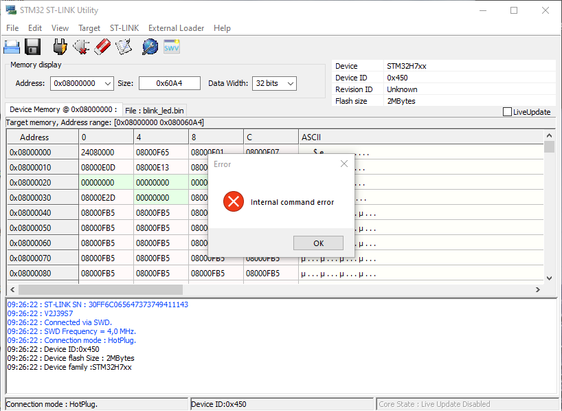

Hello, I am working with STM32 Nucleo board (NUCLOE-H743ZI2),I have an issue while writing with external debugger stlinkV2. I have connected to microcontroller and able to read the flash memory but I was unable or erase or write into the memory.
GHARI.1
0693W00000Kb3ycQAB.png0693W00000Kb40TQAR.png0693W00000Kb40iQAB.pngI am also attaching the error file from STLINK utility. Can anyone help to sort this thing out.

ST-Link Utility is NRND status. Does it work with STM32CubeProgrammer?
We are facing same issue with STM32CubeProgrammer.
We are getting write protection error and core halted errors so how to solve this issue.
When you use the ST-LinkV2 embedded on the board, what do you get?

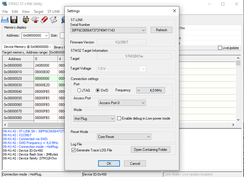

As first why you dont do , what is in red on image. Change mode from Hotplug ....
