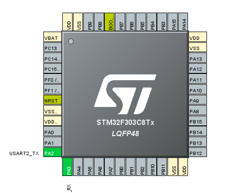

To use the ST-LINK/V2 one you'd need to check the schematic/manual to determine the USART and pins envolved.

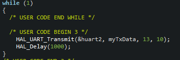

i've send data with uart protocol and wanted to visualize this data with this Realterm software but the com port didn't appear and i've used the ST-Link USB.
and i'm out of solutions right now and i can use some help.
Show what you've actually coded, the USART used, and the pins.
nothing it's just a simple code that i want from it to visualise what i just send with the realterm software but the com won't app0693W000008zQpsQAE.png0693W000008zQpdQAE.pngear
