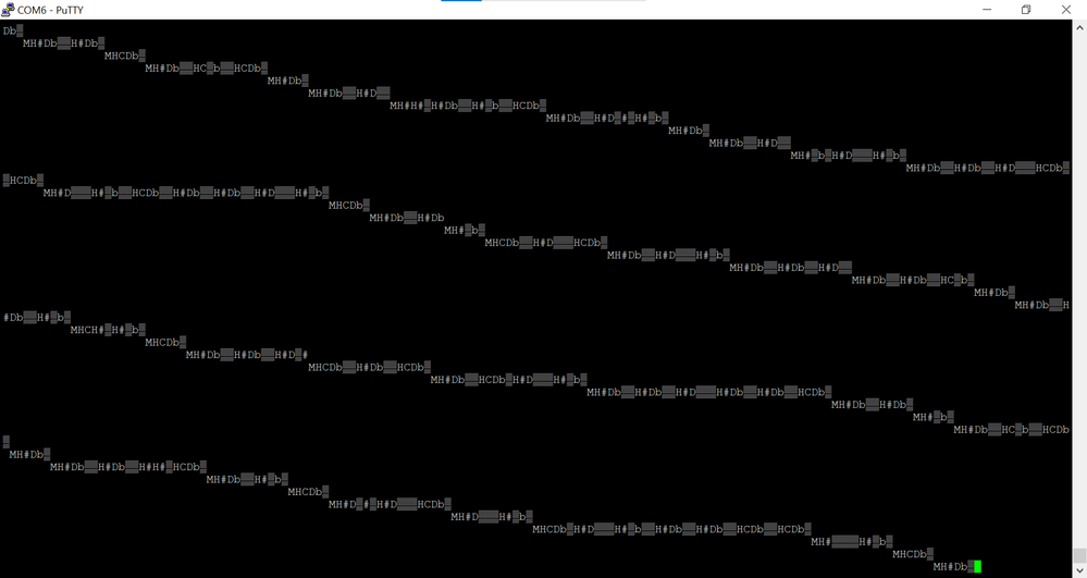

I'm using a STM32L152C-Discovery and a USB-RS232 adapter to receive data via UART protocol from the board. The system clock is 32 MHz and I'm using a baud rate of 115200 and no parity check. To view the messages on the PC, I use Putty configured consistently with the transmission parameters. When I try to send data via HAL_UART_Transmit the serial monitor shows completely different data. In the case of repeted "Hello world" message I get the following result:
I also thought about low precision clock problems, if this were the case, how can I verify the correctness with the oscilloscope?

If you want to find the rootcause within 30 minutes, use an oscilloscope on TX Pin of the MCU.
Probably not, which USB-RS232 are you using?
As @S.Ma​ said, just use the UART connected to the stlink, you dont need to connect anything extra.
