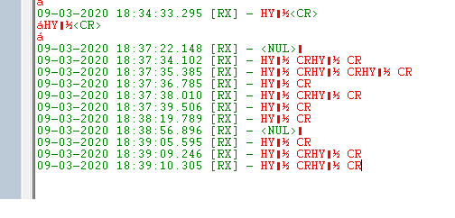

Hello Community!!
I am trying to send string to UART but it's not transmitting.I am using STM32F030R8T6 Valueline board.However when I am transmitting single char or decimal value it's going.
‎2020-03-09 12:16 AM
sprintf(buffer,"Hello\r\n");
len=strlen(buffer);
HAL_UART_Transmit(&huart1,(uint8_t *)buffer,strlen(buffer), 0xFFFF);
HAL_Delay(100); // just in case required delay is given

‎2020-03-09 6:10 AM
This is not working...Only first character is getting transmitted followed by garbage value
‎2020-03-09 6:10 AM
Same with this.......Only first character is getting transmitted followed by garbage value

What receiver are you using?
What is the hardware connection between the STM32 and receiver?
What are the baudrate etc. settings?
Do you use a crystal/HSE on the STM32?
Have you observed the waveforms using oscilloscope/logic analyzer?

I am reading it through max3232 . Connection was done through jumper cable.
Baud Rate is 9600, Word length is 8 bit with non parity bit, Stop bit is 1, I am using HSI with x12 PLL,sysclk is 48MHz.
I did not observed waveforms yet...
