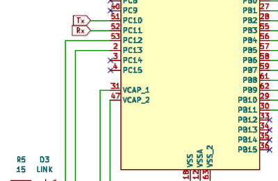

The STM32F415 transmit and receive lines are connected to the MAX3232 chip. The board also contains chips to control LEDs and read tokens, which are controlled by the STM32F415, and those functionalities work, but I am having issues with the RS-232 communication. I get nothing on the receiving end. When I hook up a scope to the transmit line for UART4 (pin 51) on the STM32 chip, it is always high (3.3 V) and nothing is transmitted. What could cause this issue?

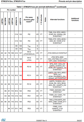

TX and RX here match the datasheet:
https://www.st.com/resource/en/datasheet/stm32f415rg.pdf#page=59

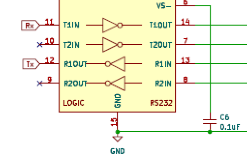

But this is wrong:
RX is an input to the STM32 - so should be driven by receiver R1OUT;
TX is an output from the STM32 - so should drive transmitter T1IN.

This is a custom board. It has not been tried on an ST board. Below is the subset of the schematic with the STM32 and MAX3232 chips.
Parts of this code including the SystemClockConfig are reused from another group. I didn't do the individual bit setting in that function. I'm wondering if something is missing from that, or if the Tx/Rx lines are swapped somewhere, or there is something else wrong. I ended up with this board, and both hardware people who took the old design and modified it to this have left the company.

But this is wrong:
Thanks for identifying that. We'll work on getting a new board. Thanks!
