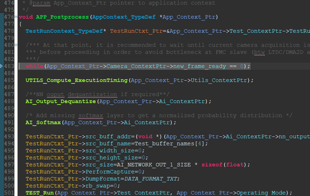

Hello Everyone!
I'm facing a problem with all the examples on this package FP-AI-Vision and my LCD only displays noises. I have the board STM32H747I-Disco model MB1248-H747I-D03 and the display MB1166-A09. I realized that in this package doesn't has the drive NT35510 and this is important for my display to work, because of that I had changed the files STM32Cube\Repository\FP-AI-VISION1_V3.1.0\Drivers\BSP\STM32H747I-Discovery and STM32Cube\Repository\FP-AI-VISION1_V3.1.0\Drivers\BSP\Components to include all packages inside STM32Cube_FW_H7_V1.11.1. Also, I had modified  the file stm32h747i_discovery_conf_template.h to include USE_LCD_CTRL_NT35510 1U and add the correct include path on the project. I had try to debug my code and it seems that the code is runing in this method:
I appreciate if you can help me.

Hello @brunamark ,
Could you please try to follow the steps shared in this wiki  page https://wiki.st.com/stm32mcu/wiki/AI:How_to_use_Teachable_Machine_to_create_an_image_classification_application_on_STM32  and precisely in section 3.1.4.
Please take a look to Model zoo, this packages enables to deploy image classification and object detection models in a very easy way on the STM32H747I- Disco and supports the  NT35510 drivers.
Thank you.
