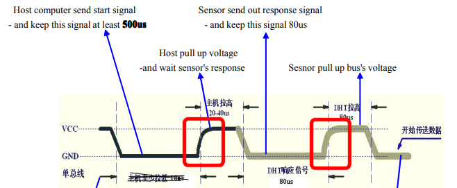

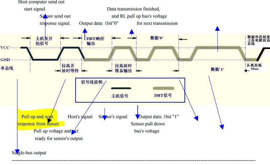

the same code worked fine with same sensor with both f4 and f0 MCUs as per datasheets its mandatory requirement to pullup and wait
‎2021-03-02 5:02 AM
"the same code worked fine with same sensor with both f4 and f0 MCUs"
So, again, compare what happens with your working code against what happens with your non-working code - that will show you where it's going wrong.
"its mandatory requirement to pullup"
Did you read my previous reply?
"Pullup" means that you let the pullup resistor do the pulling - you do not want the controller to actively drive high.
It's exactly the same principle as used for I2C: the drivers only ever pull down - it's the pullup resistors which do the pulling up.
That's why you see the rounded rising edges:

Hello Andrew.
You have resolved a question that was giving me headaches. I was wondering after this, why this code wasn't working for me. I have this board and it already has installed a pull-up resistor. But the guy from controllerstech, was using the sensor without the board, so no pull-up is included. He actively set pin high, with HAL_GPIO_WRITE_PIN() function. But in my case, my datasheet shows a rounded edge as you mentioned.

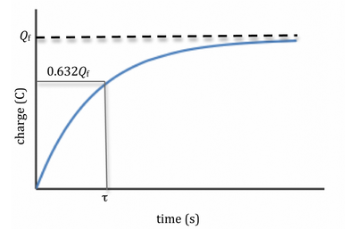

@pablo1409 wrote:you knew that a rounded edge represents that this pin have to be activated with a pullp/up resistor, how do you know that?
That's characteristic of a capacitor being charged through a resistor:
https://www.webassign.net/question_assets/ncsulcpem2/lab_4/manual.html
In this case, the "capacitor" is the capacitance of the cable, PCB trace, etc; and the resistor is the pullup.
