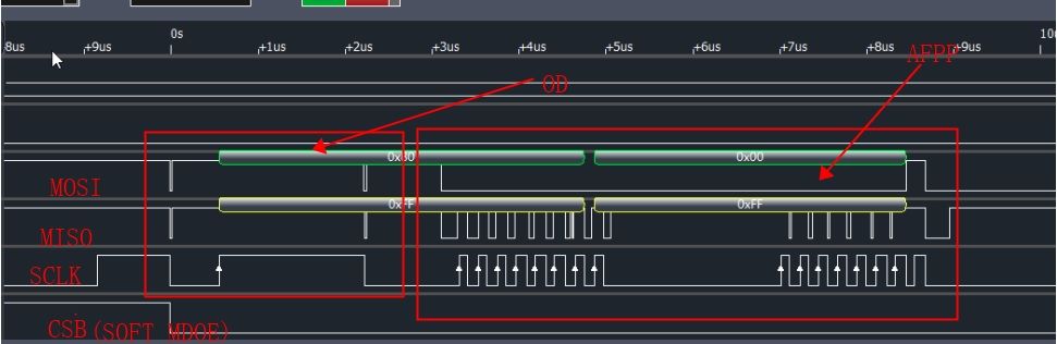

The slave device on my side is a fake PP output. It needs a pull-up resistor. I know this is not in accordance with the SPI agreement, but there is no way. When I run the HAL_SPI_Transmit() function, an incorrect pull-up signal will appear in the first cycle of initialization. If I remove the pull-up resistor, the wrong pull-up signal will disappear. So I think HAL_SPI function has wrong OD output in the first cycle of initialization.
0693W00000Hpp9JQAR.bmpMy English is not very good. This is generated by translation software. I hope you understand.

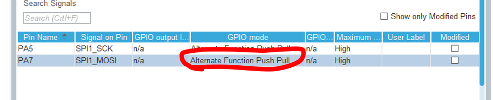

There is no need to guess. The pin mode is shown in CubeMX and can be verified by looking at registers.
Before the peripheral is active, the line is not driven on the STM32 side. If you need it to be high or low, you will need an external resistor.

> STM32CUBEMX V4.25.1
This is a very old version, but it should still show the mode.
0693W00000HppXzQAJ.jpgThank you for your reply

My question is why there is an OD signal before sending data in the first cycle of initialization.
As shown in the figure, there should be no signal driven by the pull-up resistor.
 key factors:
1,Only the first signal after initialization appears.It won't happen again
2,If there is no pull-up resistor, this signal will not be generated
3,Occurs only after HAL_SPI_Transmit () or HAL_SPI_TransmitReceive() function is called. It only occurs before the data occurs. After the data is sent, the OD phenomenon will not occur again.Since this happens inside the HAL_SPI_Transmit () function, my CSB signal cannot remove it from it.

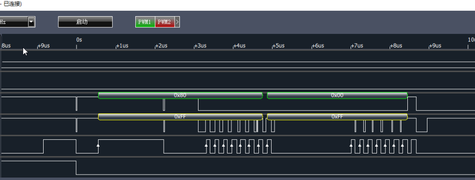

Can you please show us the correct waveform?

>1,Only the first signal after initialization appears .It won't happen again
Initialization was completed at startup. This time has been initialized. So  there should not be no driving force.

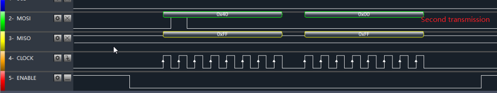

0693W00000Hpv1LQAR.jpgThe second transmission has no wrong clock signal.Never again.

Do a dummy transaction after initialization to enable the peripheral before you set CS low. The other lines toggling before that point is a non-issue.
HAL_SPI_Transmit(&hspi1, spidata, 1, 0);
Or just enable the peripheral.
__HAL_SPI_ENABLE(&hspi1);
wow�?�?�?Solved�?�?�?
thanks very very much�?�?�?
__HAL_SPI_ENABLE(&hspi1);This command is added to the initialization function, and the problem is solved.
