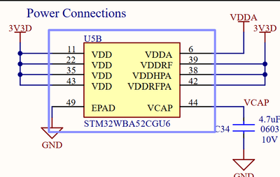

The problem I am facing is that I can't seem to get passed the SystemClock_Config() function call, more specifically, the HAL_RCC_OscConfig() function returns HAL_TIMEOUT in this part indicating that the HSE is not getting ready.
        /* Wait till HSE is ready */
        while (READ_BIT(RCC->CR, RCC_CR_HSERDY) == 0U)
          if ((HAL_GetTick() - tickstart) > HSE_TIMEOUT_VALUE)
            return HAL_TIMEOUT;

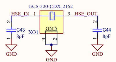

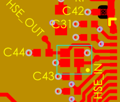

I checked the load capacitance of the external crystal and tried to trim the clock using the registers on the STM32 by using HAL_RCCEx_HSESetTrimming() but I was unable to find how the value in the register maps to a specific capacitance. This led me trying every single possible value (0-0x3F) but that made no difference. I have already resoldered a new crystal and a new STM32 so I am now believing the I have a layout issue in my PCB that's causing the crystal to not start. I have checked the Power to VDDRF as well
crystal: ECS-320-CDX-2152
Kai_Giner_5-1780545236351.pngKai_Giner_6-1780545249462.pngKai_Giner_7-1780545291789.png
Any idea what the issue could be?

@Kai_Giner
Typically, with other STM32, the load capacitors for the HSE are indeed connected externally - however, this is not necessary for the STM32WB and STM32WBA, as you can read in:
  • for STM32WB in AN5165, section 3.4
  • for STM32WBA in AN5948, section 4.4
Therefore please remove C43 and C44.
