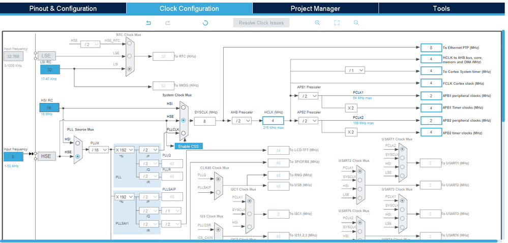

I am using stm32f767zi nucleo board and they HSE clock input is coming from st link debugger which according to data sheet of the board generates an 8 MHz MCO signal which is fed into the OSC_in pin. I have configured HSE bypass as the clk source for my mcu and configured the SYSCLK to be 8 MHZ(same as HSE). there is no PLL. However when I try to call the above method to see the current sysclk freq, the degugger shows it as 25 MHz which is clearly wrong.
my code for configuring clock is shown below.

However when i monitor the value of uint32_t SYSCLK = HAL_RCC_GetSysClockFreq(); this shows 25 MHz. the image is shown below.
What could be the issue here

I see, this was set to 25MHz by default, changed it to 8 MHz in hal_conf.h file and now its working. Thanks
‎2021-11-20 3:19 AM
HAL_RCC_GetSysClockFreq() is open source, you can find out how does it infer the system frequency.
As it can't guess the HSE frequency, you (and by "you" I mean also CubeMX/CubeIDE/whatever-clicky-you've-used which generates code) have set it somewhere incorrectly (search for HSE_VALUE).
